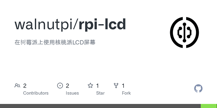

Hi. I bought a walnut pi 3.5 screen and I’m strugling to connect it to my RPi 4b (as well as RPi zero w, that I also own)
I installed a brand new raspbian, update/upgraded it and followed the instructions from here:
Still, after reboot, I see a white screen, connected to my rpi.
Please, assist me with debugging or give hints, how I can make it work.
